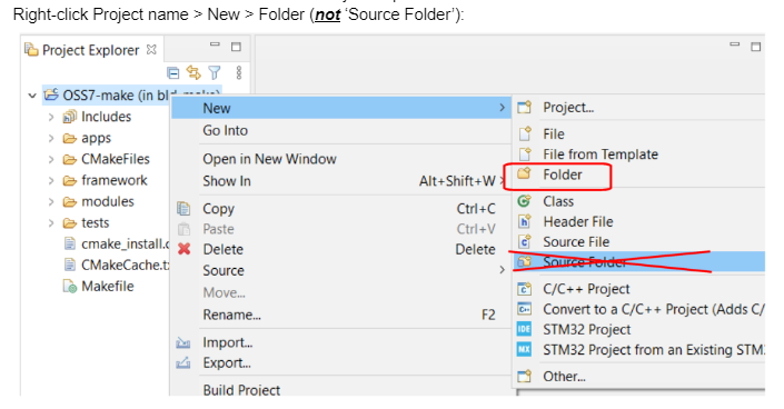

But, if you really do want to do it, you can add a file as a "link":
This takes you to:

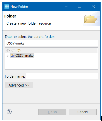

Choose 'Advanced>>'

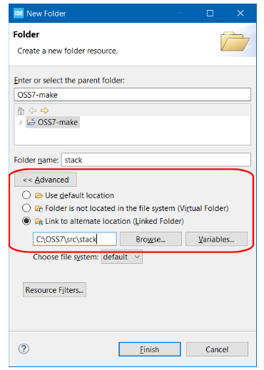

Then choose ‘Link to alternate location’, and enter the path to your source files:
This takes you to:
Choose 'Advanced>>'

Seems like trying to include H-files from this common folder needs the full path specification in the C-file.(I tried to add the include path to the build settings, but this doesn't do the trick)
How do I instruct CubeIDE to also include the H-files from this added folder?
kris2399
Sorry, please disregard previous comment: adding the path to the project does solve the issue.
