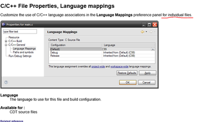

How to tell CubeIDE to compile specific *.c files with C++ compiler ?
‎2024-12-02 6:13 AM - edited ‎2024-12-03 2:41 AM
Changing suffix from *.c to *.cpp is not an option.
[edit] Changing the suffix from *.c to *.cpp is the least preferred option.
Thank you

‎2024-12-03 12:58 AM
@ferro wrote:"Compiler options can be modified per file."
Where, how ?
As I showed earlier
‎2024-12-03 12:59 AM
As I said this does not work.
‎2024-12-03 1:18 AM - edited ‎2024-12-04 5:57 AM
Thanks,
Andrew Neil suggested the same : 1st is suboptimal and 2nd does not work as this setting is at project level not a file. [Edit] It is supposed to be per file but seems to not work as described

You can exclude the file from build and build it separately using a make file. You can run this command prior to building as an extra build step. Then add the o-file to the linker: https://community.st.com/t5/stm32-mcus-products/how-to-link-an-already-generated-object-file-in-existing-project/m-p/124589/highlight/true#M22428

‎2024-12-03 2:02 AM
"Rightclick the file. Click properties. Click C/C++ General. Click Language mappings. Then select GNU C++ from the drop down menus."
Did you actually try this ? I did not get reply from Neil.
‎2024-12-03 4:07 AM
@ferro wrote:"Rightclick the file. Click properties. Click C/C++ General. Click Language mappings. Then select GNU C++ from the drop down menus."
Did YOU try this? I don't have your project. Since it says it overwrites project wide settings I think it only overwrites project wide defaults for that file. It wouldn't make sense if it would overwrite settings for other files. What would be the point otherwise? I only tried to see if my project had such an option, but I'm not going to modify it.
