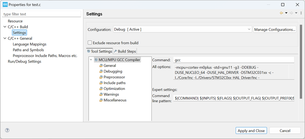

Here, the original C recipe is used despite setting C++ in mapping.

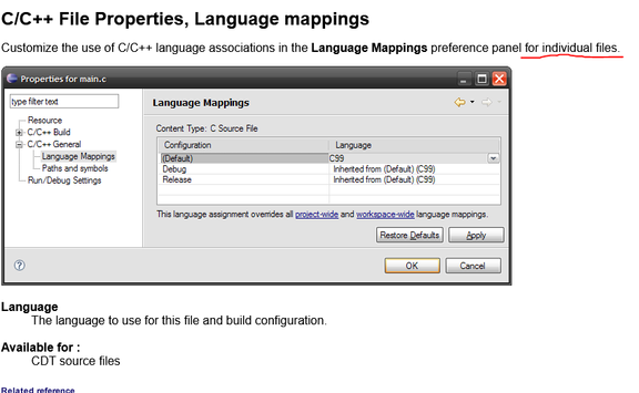

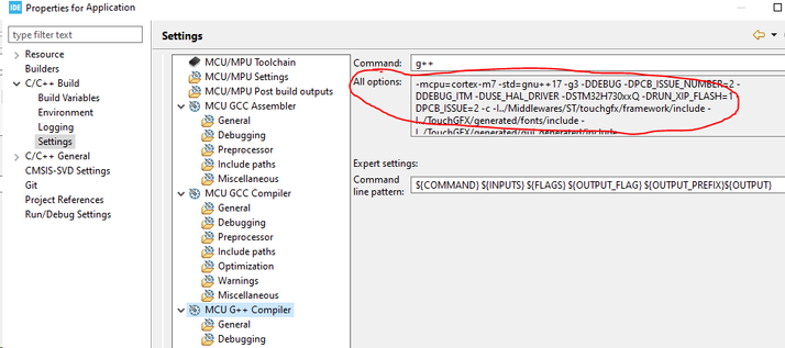

I tried various ways to override the file settings and language mappings and even editing the .cproject xml file manually (copying the settings of the cpp file from the xml). It doesn't work. So strange. The only thing that worked was modifying the build command to g++. But this doesn't take any of the project wide C++ settings and defines. It even compiles it with -std=gnu11. So this is ugly but it works.

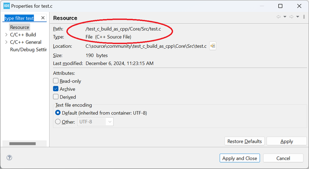

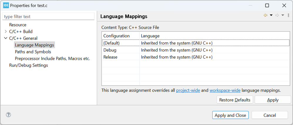

I tried something interesting. The properties of the file test.c showed "C Source File" regardless of my language mapping. So Eclipse uses some type of pattern filter based on file extension to determine the type. I was able to override this:
  • on the project: rightclick properties
  • C/C++ General
  • File Types
  • Use project settings
  • File Types
  • add: filename=test.c, Type=C++ Source File
Now it shows the correct type. And the language mapping tab is automatically set to "C++ Source File". However in build it still shows the C compiler. Even after deleting the source file and adding it again. So it seems Eclipse uses the associated source type only for some purposes (syntax highlighting?) and not for actual compiler language selection. And language mapping is ignored.
So "type" doesn't do anything.

"The only thing that worked was modifying the build command to g++. But this doesn't take any of the project wide C++ settings and defines."
I am also trying to find out if it is possible to access a build variable, if there is such, that hold all C++ or C options.
