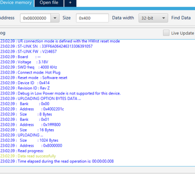

 i tried the STMCude Programmer, it works perfectly.
So you can program on CubeProgrammer, but can't program or debug in CubeIDE ?
In that case, post the full logs from CubeIDE (copy & paste as text); also screenshots of any message(s) that pop up.

What Serial Number does CubeProgrammer report for the ST-Link?

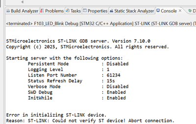

hi Andrew, yes can download on both STMCube Programmer and ST Link Utility but cant debug, error as below

Likely a fake/clone MCU - not a genuine STM32.
Try the diagnostic tool here:
https://community.st.com/t5/stm32-mcus-products/blue-pill-stm32f1-programs-ok-via-arduino-ide-but-not-keil-chip/m-p/667946/highlight/true#M242513

I guess, when it comes to debugging, it's more important to fully identify the chip than just for programming?
