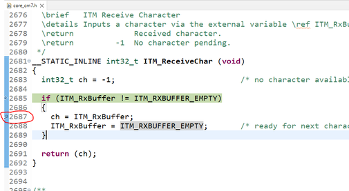

extern volatile int32_t ITM_RxBuffer;
volatile int32_t        ITM_RxBuffer = ITM_RXBUFFER_EMPTY;
int SER_GetChar (void)
    return ITM_ReceiveChar();
Breakpoint at Line 2687 is never reached.

@ferro wrote:
This means that you didn't receive any character as the buffer is empty according to the if condition.

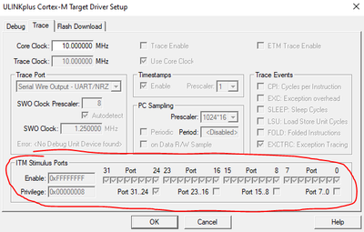

I remembered ITM settings in uVision - is something similar in Cube ? Is ITM in Cube set for semihosting internally ?
Clearly it is a black magic to me. I checked what ITM is - part of Cortex M debuging suite. So, is not this supported by STLink ? There is GBD, STLink, some code on target, Cube. Anything else in the chain ? Cannot be Cube in control of this chain so that console printf/read is woking smoothly ? Very confusing.

See this video, especially at @1:12 for ITM configuration.
