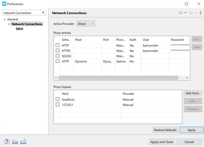

Hello @AmaniAlzahrani ,
If your machine is connected to the internet via a proxy, you need to set the correct connection parameters
[Host ; Port] to establish the link to the server.
In this case, you should set the Active Provider to manual, otherwise you can work with the Direct option.

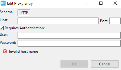

Hi, Mahmoud Ben Romdhane,
Thank you for responding
I am following these steps in the provided post
There is a step that says: "Update the proxy entries for HTTP and HTTPS with specific HOST, Port, User, and Password using the [Edit...] button"
I do not understand what the HOST, Port, User, and Password should be.

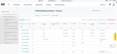

Also, at a later step, when I opened the provided website to download the software package, I didn't know which to download.
This is what is shown to me:

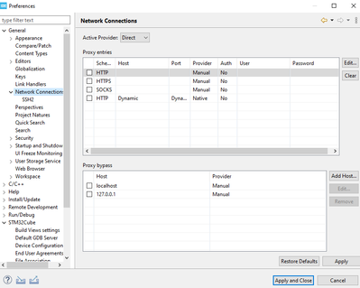

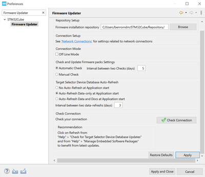

I advise you to set the Active Provider: Direct under:
Window->Preferences->Network Connection
Then check the Connection under:
Window->Preferences->Firmware Updater->Check Connection

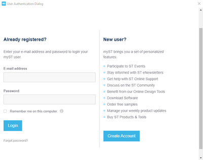

Then log to your ST Account
After the IOC configuration, click on Generate Code [CTRL¨+S] and the firmware will be successfully downloaded.

Thank you Mahmoud,
As for the second and third steps (checking connection and logging in), I did that
but, the first step, I don't know what the host and port should be

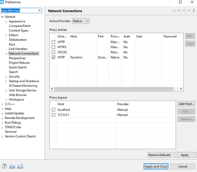

Thanks.
