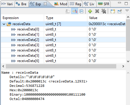

I can't really see how the "Expression" window in the STM32CubeIDE in Debug mode is interpreting arrays.
I have an array "receiveData" with 7 uint8_t elements that I receive via UART.
When I check out this array under "Expressions" I see that the array has 7 elements, just as expected. But while the value is != 0, all array elements are shown with value 0! I would have expected the first to Hex-digits from "value" belonging to element 0, the next two digits to element 1 and so on.
And in the detailed window at the bottom of the screenshot it only shows 6 times "\0" under details, not 7 times.
So my two questions are:
  • Why are all elements 0, while the value of the array in general is != 0?
  • Why is the "Details" parameter showing less elements than the array actually has?
The Value for receiveData is the address of the array, not the values within the array.
It has 7 elements, which matches the definition. The first element is index 0.
A.D.
Oh right, it is the address, that makes sense.
But still, under "details" it does show only 6 elements, not 7.
Looks like it's interpreting it as a string and leaving off the terminating null character, but including null characters "within" the string. Who knows.
A.D.
I guess that makes sense. OK, thanks for the quick answers!
