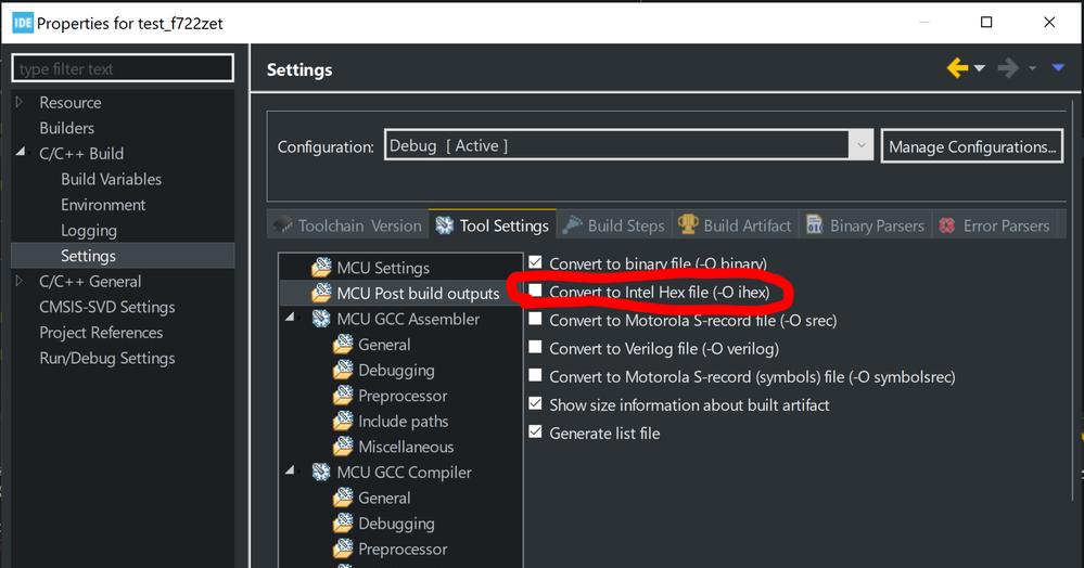

how to get an HEX file instead of an ELF

Ozone
Principal III
CubeIDE tutorial ?
objcopy ?
adaniel
Cube irrelevant. How to force the builder to generate an HEX file instead of of ELF?
Mark the checkbox in MCU Post Build Outputs.
adaniel
Many thanks, problem solved!
