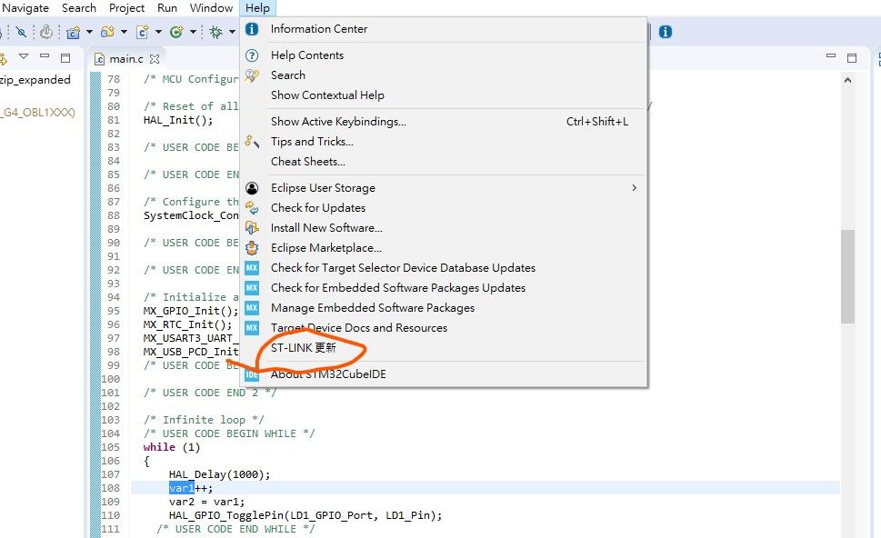

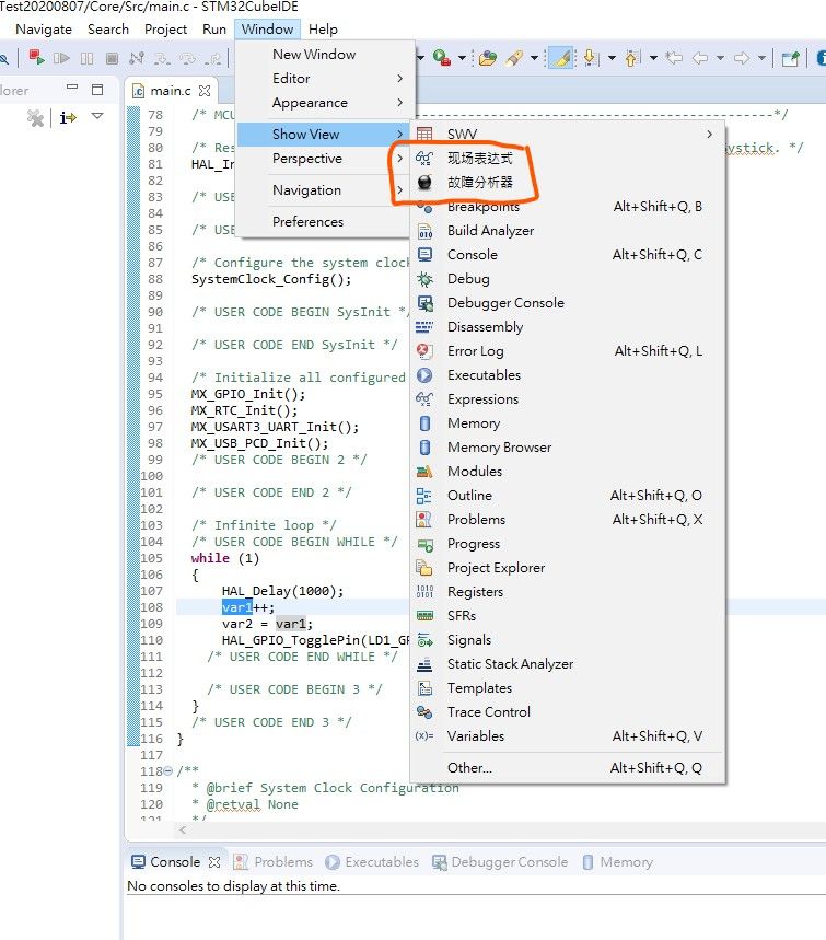

Hello all,
I just installed cubeIDE for a moment.
However, some text is displayed in Chinese such as follow,
Does anyone know how to change it to english text?

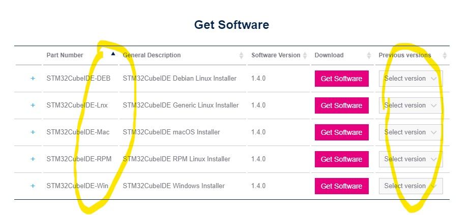

reinstall may be solved problem (select english version) while downloading
‎2020-08-14 3:56 AM
have you done ?
‎2020-08-16 10:41 PM
No, there are no selection for english version.
It just have to choice your OS and software version.

I have tried for fresh new ide of 1.4.0, nothing issue with that , download again and try once . latest edition
‎2020-08-17 12:08 AM
Yes, I tried. It's same.
I guess it may that cubeIDE will detect user OS information such like region or language setting.
My OS is WIN10, region is Taiwan with Tradition Chinese language setting.
It may be the reason, but I think cubeIDE should have optional setting for this.
