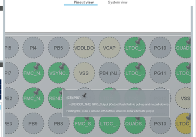

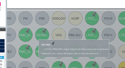

I have a stm32H745I-Disco and I would like to use some UART and I would need it to be through one of the pins that the board has called arduino connectors.
I was able to use the USART1 without problem but now I want to use it together with the display and I realize that the pins PB6 and PB7 are being used by vsync_freq and render_time.
What can I do?

STM32Cubeide indicates the following:
and if I am not mistaken in PB6 named B5 in the schematic it says that it is connected to a pin of the LCD.

It is a new code which was generated from TouchGFX and I opened it in stm32cubeide just to start configuring the UART1 as I did in a clean code from stm32cubeide and realized that the pins were already assigned by defecot to something else.
TouchGFX ver 4.24.0 and stm32cubeide 1.16.0
I will then try simply deleting what those pins were used for by default and assign them to my USART1 to see if it works.
2024-10-06 7:52 AM
Many thanks to all of you, especially to Tesla DeLorean for the help. I finally moved those pins just in case by using ctrl+left click and dragging that pin.
(PB7 to PB8)
(PB6 to PA4)
and it seems to communicate TX and RX fine and no problems on the display.
