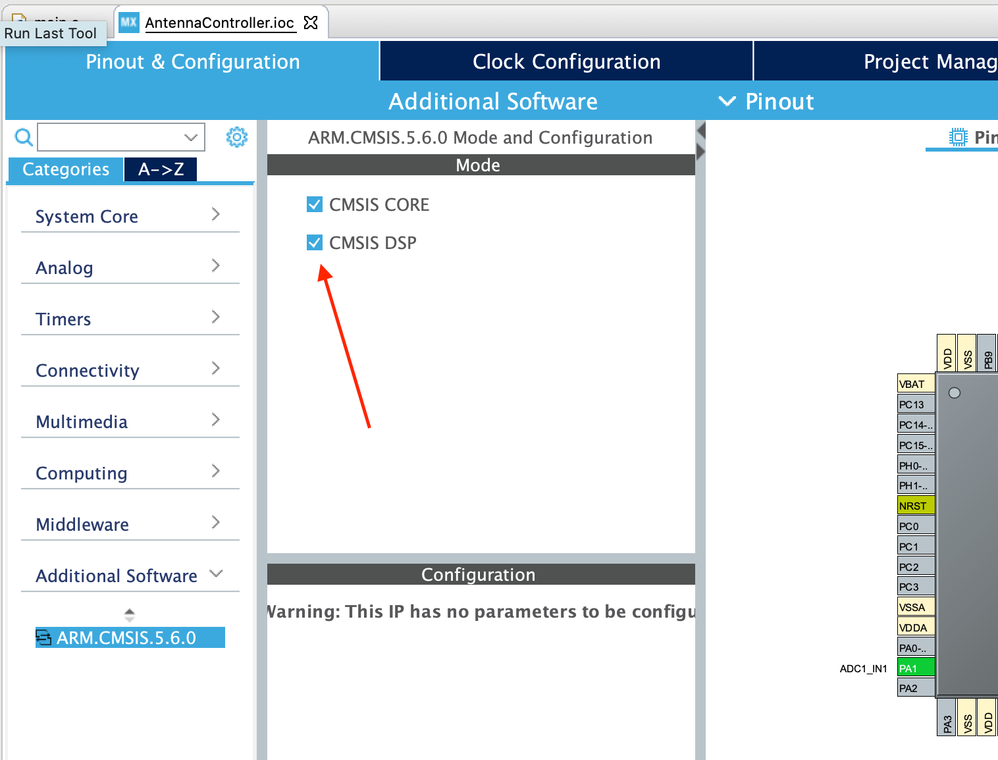

Then, in my project, in the .ioc file, I selected "Additional Software" and added the CMSIS packs:

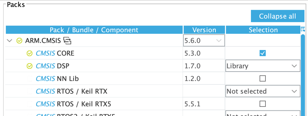

I selected to add the DSP pack as "Library".
This stem was not enough so I had to activate both packs in the .ioc file:

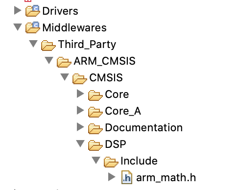

So after all these steps, I had my Middleware include files added to my project:

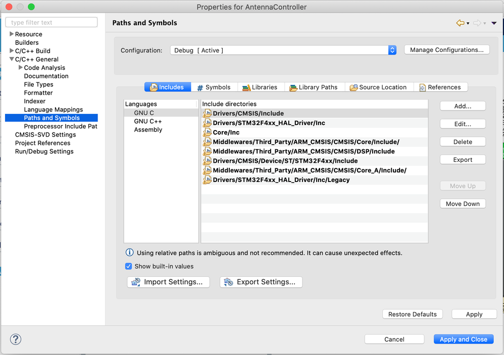

Even the include directories were automatically added to the project settings as can be seen in the following picture:
However, the libraries (.lib) are not added to the project.
I've tried adding the ARM_MATH_CM4 symbol to the project settings but it didn't help. I've also tried to add the pack as "Source" but it didn't compile.

2020-05-11 8:58 AM
I fixed it adding the library link manually but it seems like something that the IDE should do automatically. Specially considering that it copies the headers and adds the include paths by itself.
