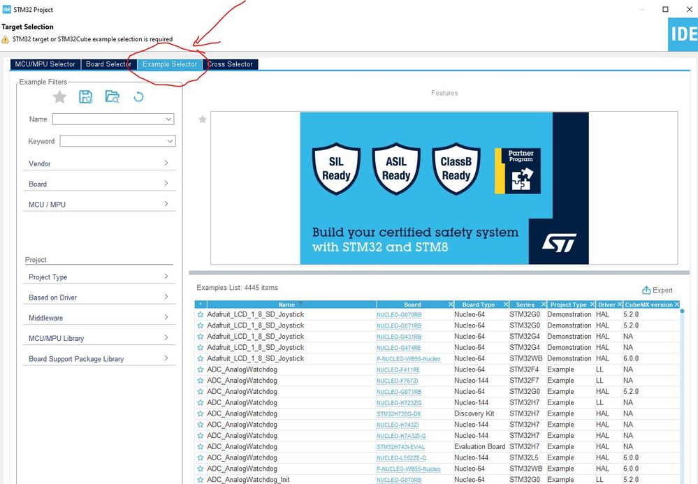

Fresh (releases done on wk31.1) STM32CubeIDE 1.4.0 & STM32CubeMX 6.0.0 are promoting some example import features !

The example projects in Cube packages refer to common library and BSP files in the same package.
These references bind the projects to the Cube package tree structure and they won't work if copied out of the tree (if you select "copy into workspace" when importing).
When you create a new project, CubeIDE offers to either copy or link the library files, but in the example projects this choice has been already made.
If you carefully copy the example at the same level in the tree, chances are it will work, as all relative references are preserved.
On Windows, make sure that neither the project path, Eclipse workspace and Cube package paths have spaces and funny characters.

Just get a look at target finder extra tab !
Also on Windows make sure that the directory path where the project is installed is not too long.
