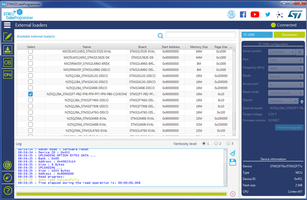

I generate a stldr file by using the method described here : https://www.youtube.com/watch?v=XqCq0xtQmbI&list=PLnMKNibPkDnHIrq5BICcFhLsmJFI_ytvE&index=5
I used it in STM32CubeProgrammer and I can read and right my external memory flash.

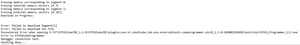

But I have an other project on STM32CubeIDE with the same STM32 and TouchGFX. I would like use this loader to program the external memory flash with images but I have an error with STM32CubeProgrammer :
The programmation of the external memory doesn't worked when I use STM32CubeIDE
Tom,
Would check if file is there, if execution is blocked by AV, or missing .DLL that the STM32_Programmer_CLI depends upon
Not clear if the error here is with spawning the file, or something on the command line, and the application is returning an error code.
If it is specifying the external loader on the command line make sure that's on a path where it can be found.
Not using STM32CubeIDE here, check if there is a subdirectory under this tools\bin for the external .stldr to live

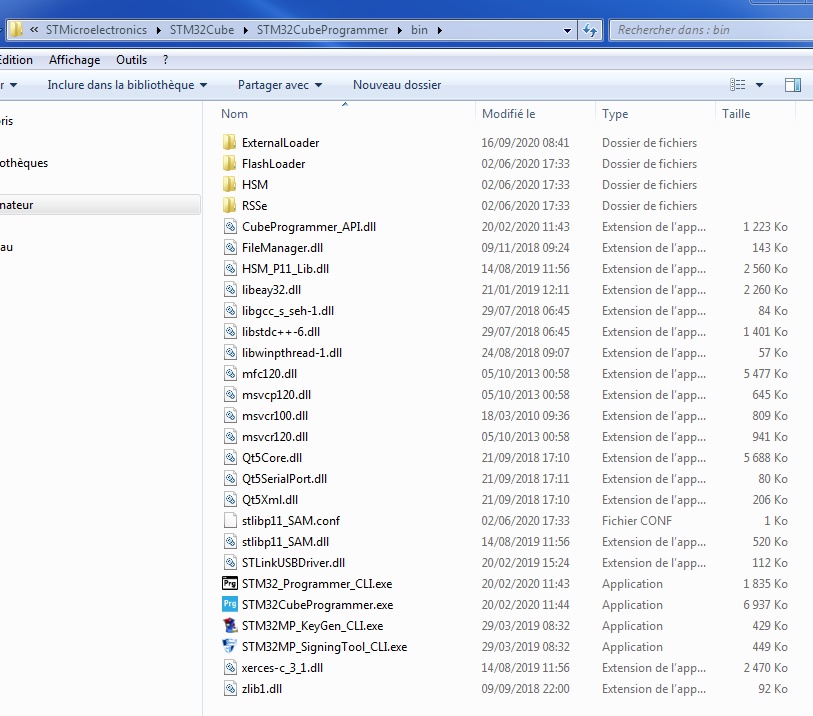

TGate.1
Hello Clive,
There is a subdirectory for external loader : C:\Program Files\STMicroelectronics\STM32Cube\STM32CubeProgrammer\bin\ExternalLoader
When I copy your .stldr file in the ExternalLoader, I can find it in STM32CubeProgrammer

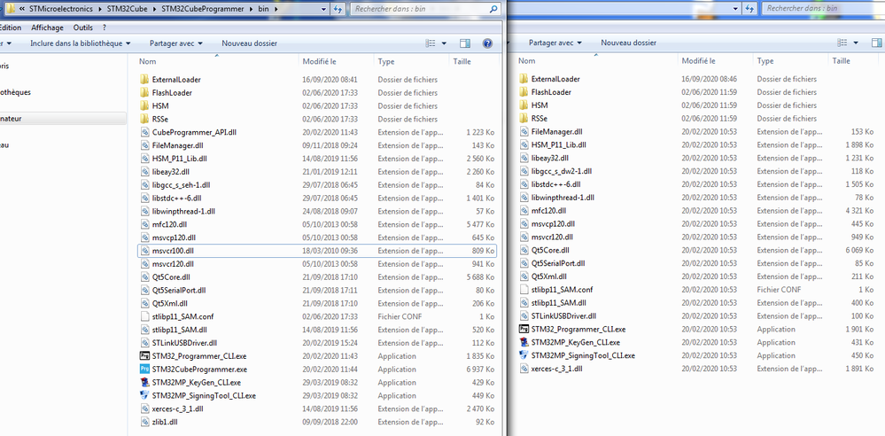

I don't know if it's normal, but it's not the same path used for STM32CubeIDE :
C:\ST\STM32CubeIDE_1.1.0\STM32CubeIDE\plugins\com.st.stm32cube.ide.mcu.externaltools.cubeprogrammer.win32_1.3.0.202002181050\tools\bin\ExternalLoader
When I compare the two folders I don't have the same files in the \bin :
