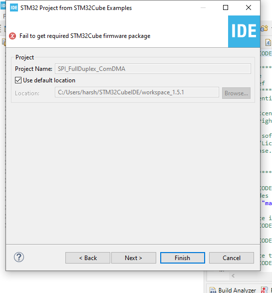

I am using the version of stmcubeide 1.5.1 and the error pic is attched0693W00000BdYAgQAN.png
The STM32CubeIDE v 1.5.1 only supports the STM32CubeH7 MCU package v1.8.0 (old release).
So, you should update and use the latest release of STM32CubeIDE (v 1.6.0 ) with the STM32CubeH7 (v 1.9.0)
Please try this and keep me informed about your update.

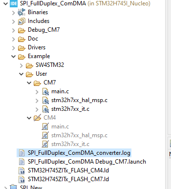

Sorry for late replying. I update the version of stmcubeide.But when project is open CM4 files are not opened. On CM4 cross marking is showing. So only CM7 .elf is getting.0693W00000CzwJGQAZ.png
