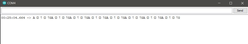

The way that I am piping the commands is shown above, and the output on my serial monitor looks something like this:
In terms of BaudRate, my ESP8266, USART1 and USART2 all use 115200. I have also tried the serial monitor at 9600, but haven't seen the responses that I expect as with my current piping setup i only receive one character ( A A W A).

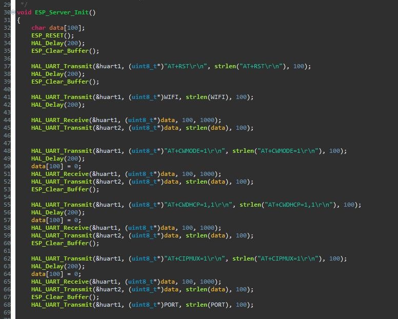

My current USART1 configuration is shown below.
I'm looking for some specific guidance on how to configure my USART for this situation. I've noticed some things where it might be necessary to try the RX on Open drain, however this has brought me no luck. My .ioc and source files are provided. My ESP8266 is powered by an external voltage source, with only TX and RX connected to my STM32L4.

Unlike Arduino, the ST "HAL" library does not do any buffering. So, sequences like this will lose the RX data:
HAL_UART_Transmit(&huart1,...);
HAL_Delay(...);
HAL_UART_Receive(&huart1,...);
HAL_UART_Transmit(&huart2,...);
 The 2nd transmit() will therefore transmit junk.
Please search and use examples of sending "AT" commands to various devices. The naïve use of the HAL library won't work. If confused and want help, get the help here.

Before starting a new TX, check that the latest last byte has been transmitted. (while flag + tick timeout).
Even at 115k2 it takes some time to shift out some bits, so the buffer or UART FIFO gets overwritten before data is out.
Not sure how these HAL functions work, but without neither interrupt nor DMA the UART is not that "elegant".

Just one question: are the gnd from your board and esp are connected?
Can you use an Oszi to verify the levels of tx and rx?

How have you verified that both your STM and your ESP are actually working at the correct baud rate?
Can your STM on its own successfully communicate with a PC terminal?
Can your ESP on its own successfully communicate with a PC terminal?
