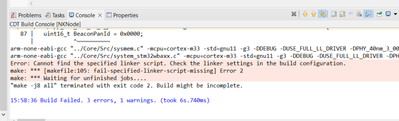

I'm using STM32CubeIDE 2.0 and CubeMX 6.16.1. When I create a project in CubeMX, it doesn't create the STM32WBA55CGUX_FLASH.ld file. It creates the makefile when I select it in the Toolchain/IDE section, but then gives an error.

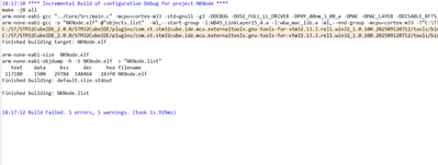

I did it this way; it gave an error in the first compilation, but it worked in the second compilation.
this is the first compilation

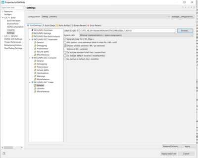

My settings are like this
first compilation
The first time I press the compile button, it gives an error.
Then, when I press it again, it doesn't give an error.

I'll send the entire line. But what I don't understand is why it gave an error the first time I compiled it, and then suddenly gave zero errors; that's very strange. And it's like this every time I make a change to the project.
arm-none-eabi-gcc -o "NKNode.elf" @"objects.list"  -Wl,--start-group -l:WBA5_LinkLayer15_4.a -l:wba_mac_lib.a -Wl,--end-group -mcpu=cortex-m33 -T"C:\TTS_YB_V01\Node\NKNode\STM32WBA55CGUX_FLASH.ld" --specs=nosys.specs -Wl,-Map="NKNode.map" -Wl,--gc-sections -static -L../Middlewares/ST/STM32_WPAN/link_layer/ll_cmd_lib/lib -L../Middlewares/ST/STM32_WPAN/mac_802_15_4/lib --specs=nano.specs -mfpu=fpv5-sp-d16 -mfloat-abi=hard -mthumb -Wl,--start-group -lc -lm -Wl,--end-group
C:/ST/STM32CubeIDE_2.0.0/STM32CubeIDE/plugins/com.st.stm32cube.ide.mcu.externaltools.gnu-tools-for-stm32.13.3.rel1.win32_1.0.100.202509120712/tools/bin/../lib/gcc/arm-none-eabi/13.3.1/../../../../arm-none-eabi/bin/ld.exe: warning: C:/ST/STM32CubeIDE_2.0.0/STM32CubeIDE/plugins/com.st.stm32cube.ide.mcu.externaltools.gnu-tools-for-stm32.13.3.rel1.win32_1.0.100.202509120712/tools/bin/../lib/gcc/arm-none-eabi/13.3.1/thumb/v8-m.main+fp/hard/crtn.o: missing .note.GNU-stack section implies executable stack
C:/ST/STM32CubeIDE_2.0.0/STM32CubeIDE/plugins/com.st.stm32cube.ide.mcu.externaltools.gnu-tools-for-stm32.13.3.rel1.win32_1.0.100.202509120712/tools/bin/../lib/gcc/arm-none-eabi/13.3.1/../../../../arm-none-eabi/bin/ld.exe: NOTE: This behaviour is deprecated and will be removed in a future version of the linker
Finished building target: NKNode.elf
arm-none-eabi-size  NKNode.elf
arm-none-eabi-objdump -h -S NKNode.elf  > "NKNode.list"
   text	   data	    bss	    dec	    hex	filename
 117180	   1500	  29784	 148464	  243f0	NKNode.elf
Finished building: default.size.stdout
Finished building: NKNode.list
08:57:11 Build Failed. 1 errors, 3 warnings. (took 2s.702ms)
Hello @YBAYR.1
It seems that this error is related to BLE applications, as mentioned in Stm32CubeIDE errata known issue: https://wiki.st.com/stm32mcu/wiki/STM32CubeIDE:STM32CubeIDE_errata_2.0.x#STM32WB0,
as workaround you can use the linker option: -z noexecstack.
BR, Souhaib
