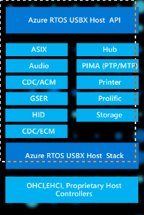

did someone try the "Azure" host ? seems there are many host types...
https://github.com/azure-rtos/usbx
Hmmm, was getting there, but that looks like the perfect solutoin!
Thank you very much!

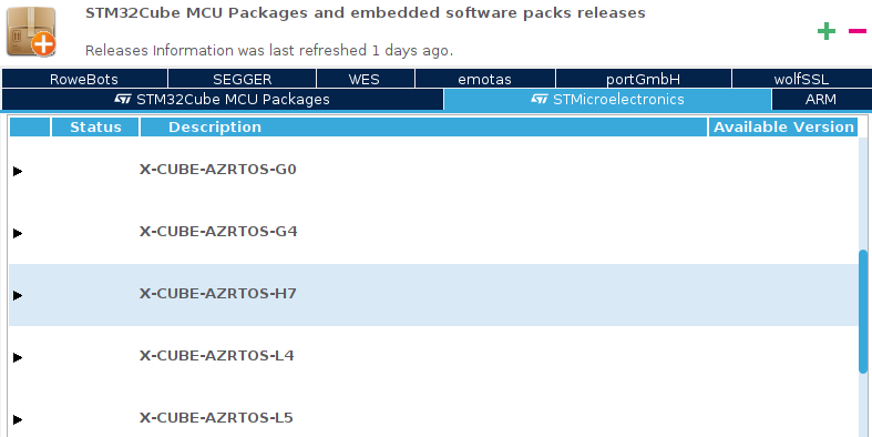

+ can add in cubeIDE :
shorai
Thanks again for rthe pointer to Azure,
The H7xx seem to be the most complete
I'm running 746 and 769 discovery boards, and so need to learn a bit more and can probably adapt the ACM driver with not too much effort.
I think most of the config can be done via the config panels in cube ;) and a 'class' for each manufacturer of USB to Serial bridge to get round the enumeration step for 'vendor specific' where class does not come in as 2.
