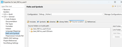

I am trying to port an example application from MDK to CubeIDE, the CubeIDE does not give me correct compilation result:
1. It completes the compilation when code contains syntax error and it produces binary. This is quite different from past experiences with CubeIDE.
2. The size of the binary is not correct (88 bytes for an LWIP application is imppossible)
3. The CubeMX does not generate startup code startup_stm32f767igtx.s
4. There's a warning: cannot find entry symbol Reset_Handler

Are all *.c files within directories marked as Source Locations?
There is no GCC-equivalent for the "__attribute__((at(0XC01F4000)))" attribute. You can define a new section in the linker and place them in that section.

As @TDK said, this suggests that not all your files are being compiled.
You can see what's being compiled in the build console window ...

Thank you so much. Also many thanks to Andrew and Pavel.
Now the project compiles okay, but linker still reports errors:
I think this should be caused by my modifications in linker script. I will write a seperate post for this.
