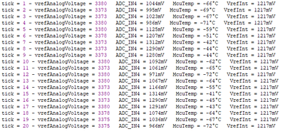

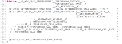

Thank you so much, now I use DMA to do it. But the mcu internal temperature calculation using predefined macro __LL_ADC_CALC_TEMPERATURE in stm32g0xx_ll_adc.h  gives result from -42 to -72 for a Nucleo-STM32G070 board, while room temperature is about +18°C.
The following is the macro:
and this is the use of the macro:
uint32_t vrefAnalogVoltage = __HAL_ADC_CALC_VREFANALOG_VOLTAGE(convertedData[2], ADC_RESOLUTION_12B);
int32_t McuTemp = __HAL_ADC_CALC_TEMPERATURE(vrefAnalogVoltage, convertedData[1], ADC_RESOLUTION_12B);
where convertedData[2] is the measured value for VrefInt, and convertedData[1] is the measured value of the internal TempSensor.
Where is wrong in my calculation ?

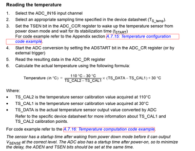

Did you set the adc for temp measuring ? (Needs special setup...slow...and wait time; read rm !! )
Thank you. It helps.
It's the sampling time issue, the default 1.5cycle is not enough, after I have chosen 79.5 cycles as the sampling time I could see the measured temperature would not fall any more. Referring to the datasheet of STM32G070, the minimal ts_temp is 5us, I am not sure on comparison between 5us and 79.5 cycles.

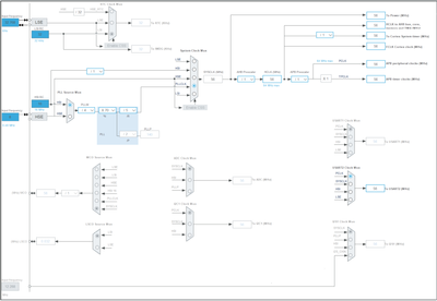

I set the SystemCoreClock as 56MHz for the Timer3, does that mean the Mcu is running with that clock, and how many microseconds for one cycle?
Regards
Chao
56MHz => period of 0.018us
79.5 periods = 1.42 us
SystemCoreClock as 56MHz -> cpu at this clk. right.
cycles of adc :  = adc clk cycles ; you set the adc clk in Cube - so you should know (look, what you set..)
if ADC_CLOCK_SYNC_PCLK_DIV2 : 56M /2 = 28M  (adc clk)
x 79 cyc = about 2,8 us , so set more sampling cycles, to fulfill 5us .
set : 160.5 cyc -> about 5,9us , seems good.
