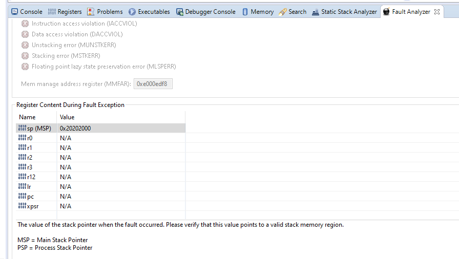

Hi, on our card with stm32L496 we have a boot partition that launch the principal application if an update is not required. All work find until i update cubeMX to version 5.6.0 ! Now when i regenerate the code (not changed between the 2 versions) of IAP i have a hard fault when i want to jump to the principal application.
The boot (IAP) is located at 0x8000000
The application at 0x8008000 --> defined in STM32L496ZGTX_FLASH.ld

the result in debug mode :

I i use an older binaries (same code but generated with older version of cubeMX 5.5 or 5.4), it works fine !
Can you help please ?

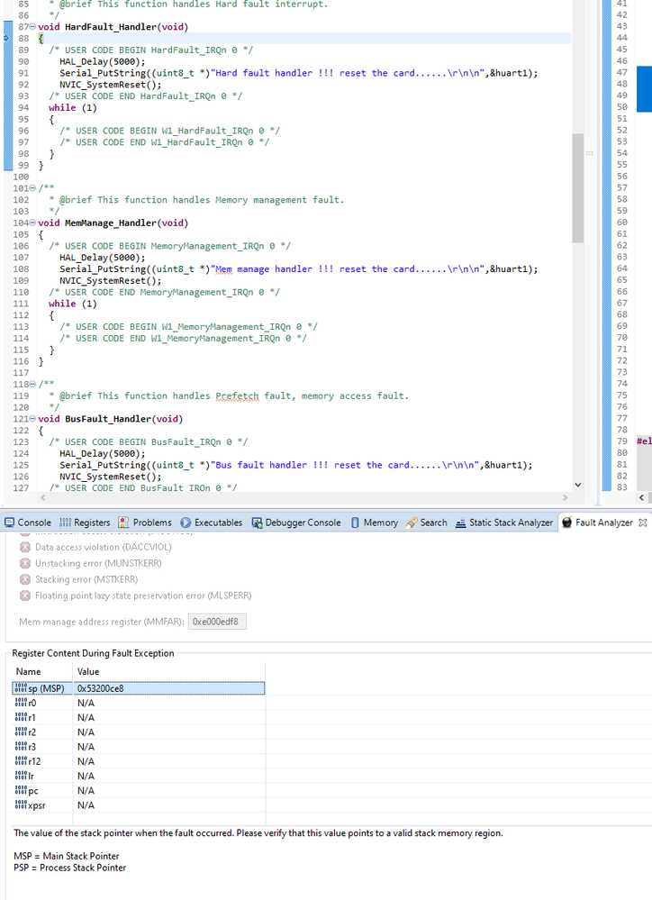

Hi, i have rebuild the boot application from a blank folder with cubeMX. I already have an error when i jump to application but the address is different now :

Build the same project with IAR work fine ! Probably an issue with stm32 cube IDE ?
MLE S.1
Issue solved --> remove older stm32 ide settings / cube mx settings
