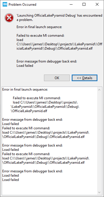

I have had a lingering issue that rears its ugly head from time to time and is a huge productivity killer. I honestly cannot say what triggers the issue, or how to fix it. It is becoming too big of an issue to continue development with the system like this.

When using my J-Trace from within STM32CubeIDE I get this output in the console window:

At the same rate, if I use an st-link programmer device I get this output to the console:

and this popup dialog:
If you look at the J-Trace log, clearly the verification of the downloaded bytes is failing, why is STM32CubeIDE telling the J-Trace to write to address 0x00008000? It looks like this address has been shifted right 3. The normal programming address is 0x08000000. Super strange and I have no idea how to fix this problem. In total this has probably caused me 2 weeks of development work dealing with it on and off, losing work as I am forced to revert to older code bases to get away from the issue (sometimes even this doesn't help);

Anyone having these issues???
I can manually flash a bin or hex file with my J-Trace without issue using the J-Link Commander application provided by Seggar. This must be an issue with STM32CubeIDE.
Is there a better place to post questions reguarding STM32CubeIDE?
I'm guessing the real question​ would be how many of the participating experts are using CubeIDE at all.
This would be the place to post, but wouldn't expect rapid responses.​
Perhaps chat with your local ST FAE for realtime support.
Are you sure it is not building from AXIM Flash?​
