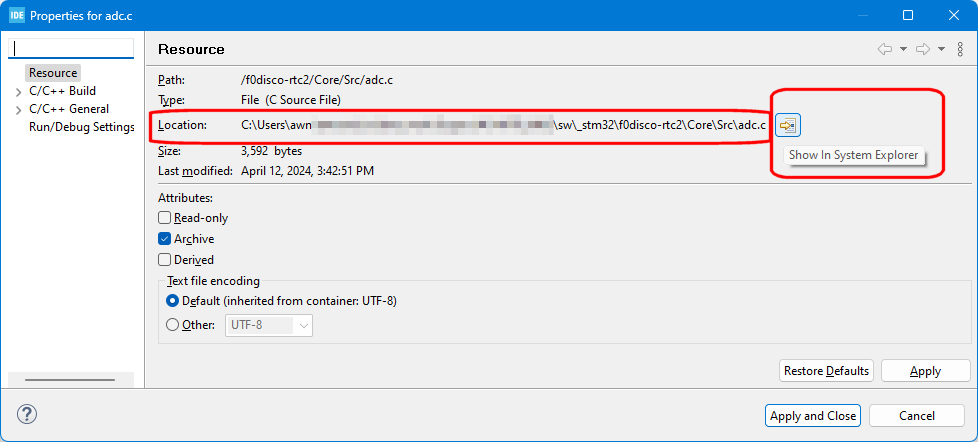

Andrew Neil
If you right-click one of the files in the CubeIDE Project Explorer, and click 'Properties' it will show you where the file actually is in the file system:
Check that this is where your GitHub Desktop is looking
