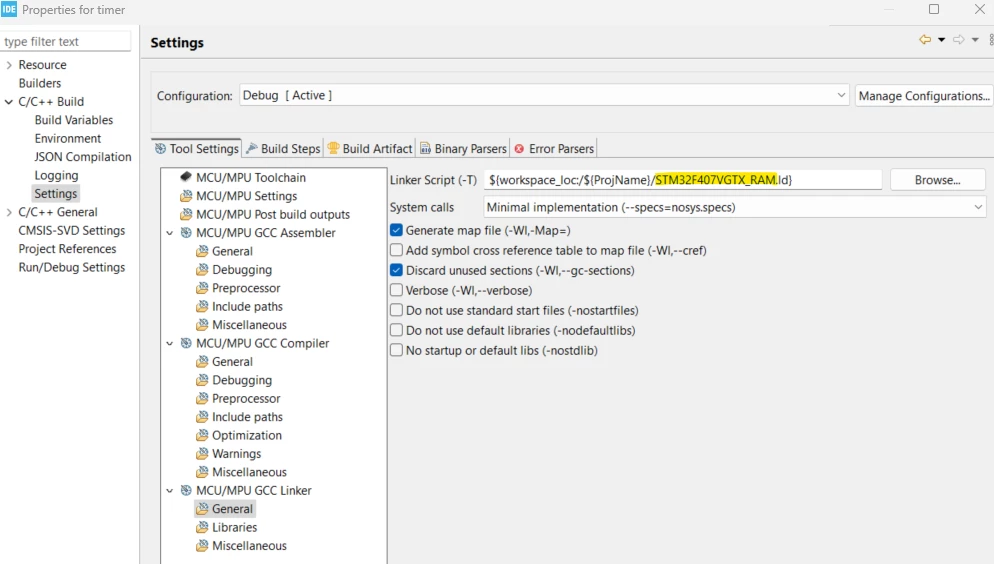

1.What is the correct way to select the RAM or FLASH configuration? As of now the way i do this is :
"project properties -> C/C++ Build -> Settings -> MCU/MPU GCC Linker -> General"
And in the General section I manually point to the linker script, Is this the correct way?

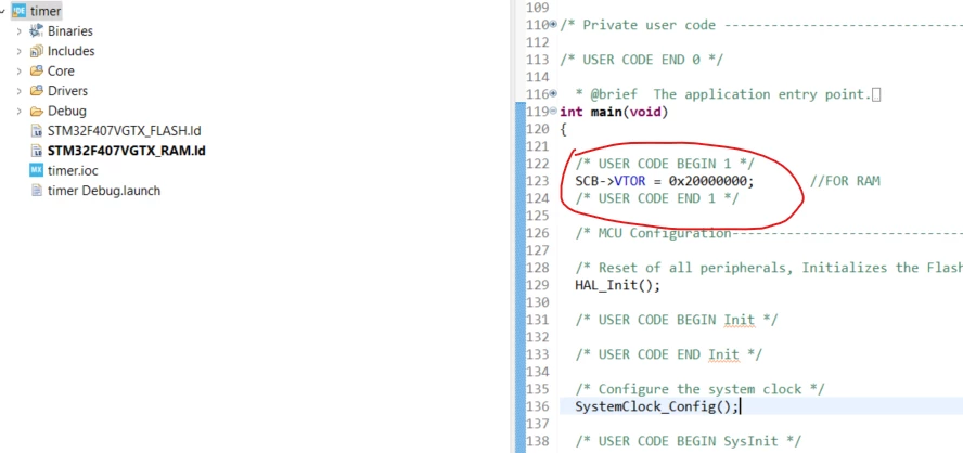

2. When running the project from RAM configuration, during debugging i noticed that the program does not run at all, doing a little searching online, I found out that the Vector Table Offset Register (VTOR) does not point to the correct location, it always starts assuming that the project runs from FLASH. After manually pointing it to the correct address then it works correctly! Is there any way to automate this , based on the selected .Id file?
Although the setup works i get this warning now:
