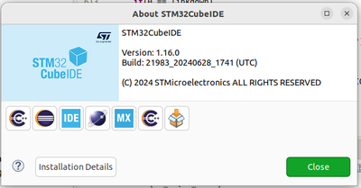

‎2024-10-02 12:46 AM - edited ‎2024-10-02 1:15 AM
The issue is still in 1.16.0 and also in 1.16.1
‎2024-10-02 1:20 AM
If you remove the .metadata directory in the workspace it works. You will have to reread/import your projects and then next time you start the IDE the problem is back. So not really a fix but more an annoying workaround.
