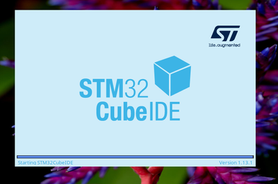

This is new "option" on splash screen:

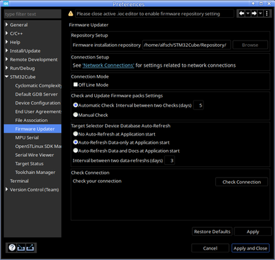

!! on top: please close ioc editor --- on startup !!! Nothing is open !!
-> Apply and Close --> nothing happens , just (static) splash screen.
Is V1.13.1 .
Only killing the java process removes the splash screen, but doesn't help , next start of IDE hangs again:
Very annoying .
