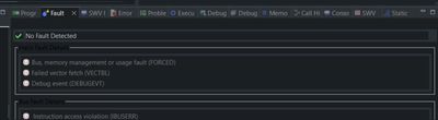

Hello everybody,
Since I did last update of STM32CubeIDE software I cannot see the fault analyzer toolbar anymore (attached file img).
Am I missing some configuration to display it?
Or is due to the update?
Thank you for your time

    lucius92Author
    December 20, 2023
    Hello @Mahmoud Ben Romdhane
    I correctly display Fault analyzer but there is no toolbar  (also when there is a fault)

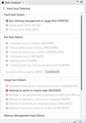

    May 22, 2024
    Did this issue get fixed?
    I don't see the Fault Analyzer toolbar in the Fault Analyzer Window or am I just looking in the wrong place for it?
