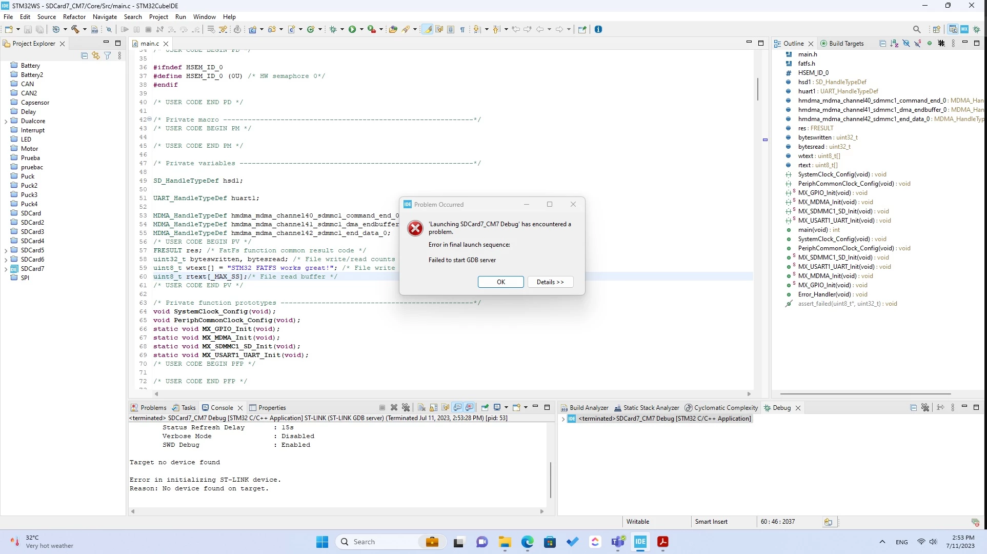

Hi everyone, I'm working with the STM32H747i-Disco, had several projects working just fine, then I tried to load the example project FatFs_uSD to the board, it didn't work and after that I keep getting the error: Failed to start GBD Server. Any Idea how can it be solved?

    Hello @JuanBT ,
    Are you using an FatFs_uSD example from STM32CubeH7?
    Which version of STM32CubeIDE are you using?
    Seems your ST-Link or MCU don't work. Please check  to connect the board with STM32CubeProgrammer.
    I think also this FAQ can help you.
    Thank you.
