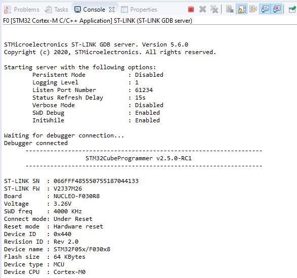

Screen shot of my config page ...
Copy and paste of the details. This makes me think I am misunderstanding the issue. As I said, if I zero out the memory with STLink utility, then program with the IDE, even with the error if I press restart the test blink works or at least the led blinks. :)

 ------ Switching to STM32CubeProgrammer -----
                       STM32CubeProgrammer v2.5.0-RC1
Log output file:   C:\Users\PAULEN~1\AppData\Local\Temp\STM32CubeProgrammer_a14680.log
ST-LINK SN  : 54FF70066782544811281767
ST-LINK FW  : V2J37S7
Board       : --
Voltage     : 3.54V
SWD freq    : 4000 KHz
Connect mode: Under Reset
Reset mode  : Hardware reset
Device ID   : 0x410
Revision ID : Rev X
Device name : STM32F101/F102/F103 Medium-density
Flash size  : 128 KBytes
Device type : MCU
Device CPU  : Cortex-M3
Memory Programming ...
Opening and parsing file: ST-LINK_GDB_server_a14680.srec
  File          : ST-LINK_GDB_server_a14680.srec
  Address       : 0x08000000
Erasing internal memory sectors [0 5]
Download in Progress:
�������������������������������������������������� 0%
�������������������������������������������������� 100%
File download complete
Time elapsed during download operation: 00:00:00.442
Verifying ...
Read progress:
�������������������������������������������������� 50%
Error: Failed to read memory at address 0x08000000 during verification
Error: Download verification failed
Encountered Error when opening C:\ST\STM32CubeIDE_1.3.0\STM32CubeIDE\plugins\com.st.stm32cube.ide.mcu.externaltools.cubeprogrammer.win32_1.4.0.202007081208\tools\bin\STM32_Programmer_CLI.exe
 ------ Switching context -----
Error in STM32CubeProgrammer
Debugger connection lost.

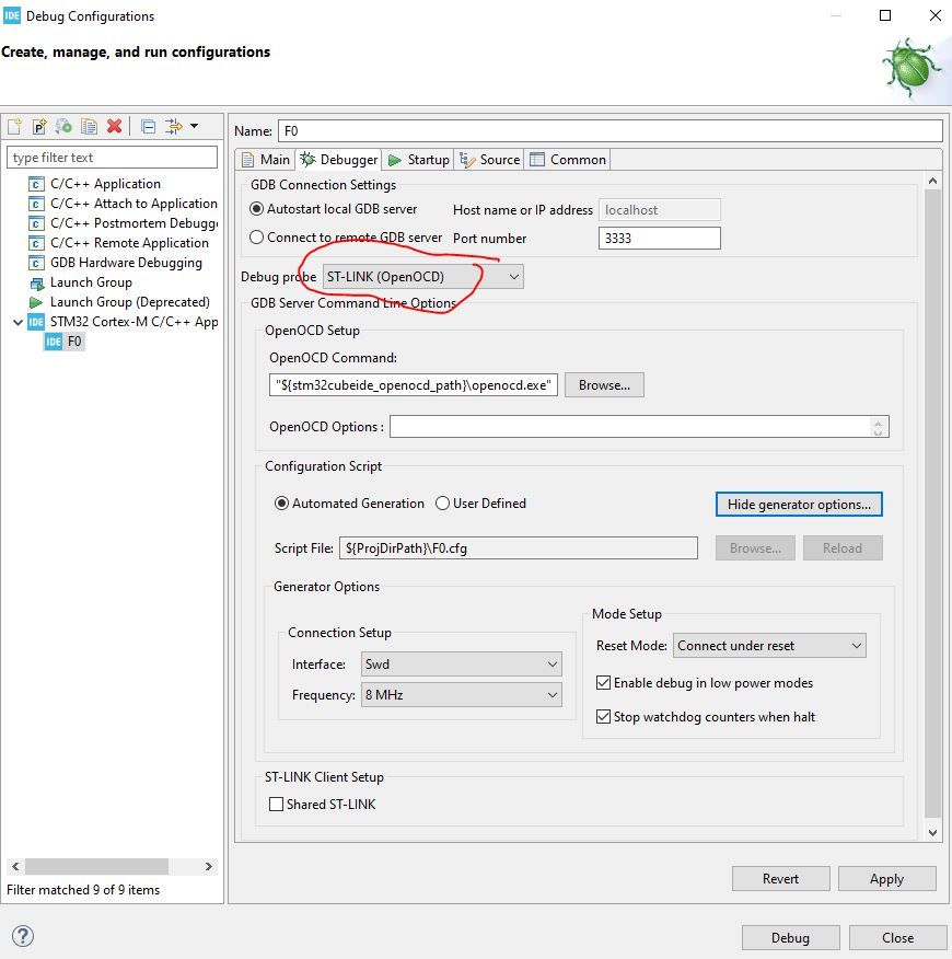

Have a try based on OpenOCD usage too ... CubeProgrammer usage is skipped here.
