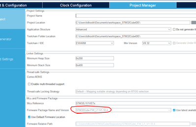

Open your IOC file, go to Project Manager and look at what firmware package it wants to use:

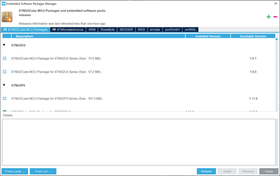

Then go to help -> Manage embedded software packages and download that package.

Hi TDK,
I confirmed that the relevant package is installed, and in the CubeMX it is showing as available.

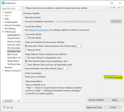

Hi @Shyam1
Thank you for posting!
please check the connection (Preference>STM32Cube>Firmware updater)

Hi Souhaib,
Thanks for your support.
I tried with check connection, and could observe the same message see in the recommendation window.
I have ensure it is up to date "Target Selector Device Database Updates"; and ensured the software packages is available in the repository.

Hi @Shyam1
Are you using a proxy connection?
if yes please refer to this link How to set up proxy and P2P Ethernet connection with STM32CubeIDE - stm32mpu to set up your proxy connection with STM32CubeIDE.
