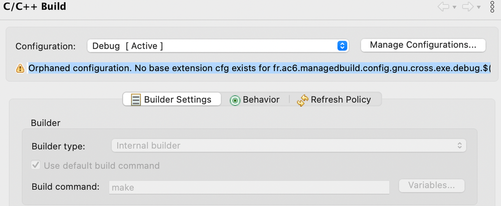

Error when building X-nucleo-IHM11M1 (motor controller board for STM32-F401RE) demo software in CubeIDE.
JLusk.1
 Import seems to be successful but the build configuration seems to be faulty. The error I get is
"Errors occurred during the build.
Errors running builder 'CDT Builder' on project 'STM32F401RE-Nucleo Configuration'.
Internal error building project STM32F401RE-Nucleo Configuration configuration Debug
java.lang.NullPointerException
java.lang.NullPointerException"
In the build menu the following error is displayed.
0693W00000HqEwkQAF.pngIs there any fix for this or am I missing something obvious?

Hello @JLusk.1​ and welcome to the ST Community.
Try to copy the attached project in this folder: ...\Projects\Multi\Applications\MotorControl
where you have the project of all the other IDEs
Let me know if this solve the error
If you feel a post has answered your question, please click "Accept as Solution"
JLusk.1
Hi, thanks for the reply.
There now are significantly fewer errors but there is still one instance where a file cannot be found, I don't know if it might be my specific install of stm32CubeIDE but in any case it cannot complete the build.
The error message is as follows:
make: *** No rule to make target '/.../STM32CubeExpansion_SPN11_V1.0.0/Drivers/STM32F4xx_HAL_Driver/Src/stm32f4xx_hal_mmc.c', needed by 'Drivers/STM32F4xx_HAL_Driver/stm32f4xx_hal_mmc.o'. Stop.
"make all" terminated with exit code 2. Build might be incomplete.
