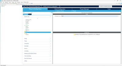

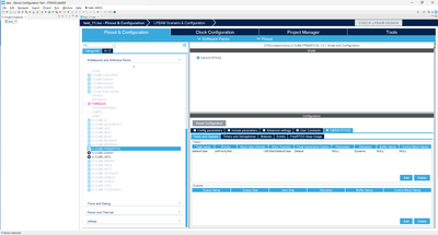

Hi
I am creating project using STM32CUBEMX for board (B-U585I-IOT02A) Non-Trust-Zone.
the above configuration done while creating project.
I am getting stuck at HardFault_Handler.
am I missing some configuration, please let me know !!

Probably insufficient heap or thread stack size.
‎2023-07-27 5:32 AM
Could you please describe how to modify the stack and heap?
currently I am using heap_4.c when created the project.
