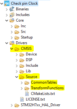

I'm trying to implement the DSP functions, FFT...but including the "DSP include files" I get several errors:
May you help me ?

Please try to copy source folder from <STM32Cube_Repository>\STM32Cube_FW_H7_V1.11.2\Drivers\CMSIS\DSP\Source to your project as shown in the below figure.
Keep only the folders containing the functions you've used in your project.
After checking the errors in your screenshot, I think you need to keep only "TransformFunctions" and "CommonTables" folders (Please check if you need to keep other source folders).
Open "CommonTables.c" file in CommonTables folder and comment all includes:

Open "TransformFunctions.c" file in TransformFunctions folder and comment all includes:

Please refer to step 4, 5, 6 and 8 under this FAQ: How to integrate CMSIS-DSP libraries on an STM32 p... - STMicroelectronics Community

Thank you Kaouthar,
I've solved the issue.
