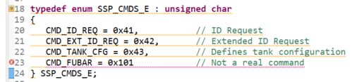

Defining the underlying type of an enumeration has been a difficult task until C23 added the feature.  Previously different compilers used different methods and results could vary unexpectedly.
As seen in the image below, STM32CubeIDE v 1.19.0 can recognize this C23 feature and flag mistakes, such as the out-of-range value 0x101 for the 8-bit enum.
As seen in the gcc output below, the mistake is caught by gcc:

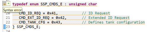

This is all as it should be.  The problem is when I remove the fake out-of-range command, gcc works as expected but STM32CubeIDE flags a syntax error:

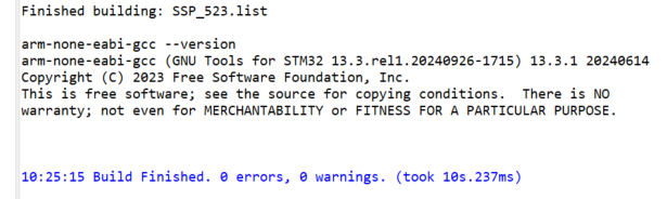

The build finished with no errors or warnings so gcc 13 understands at least this part of the C23 standard.
Is there a configuration within STM32CubeIDE to prevent displaying a Syntax error for code the compiler understands?

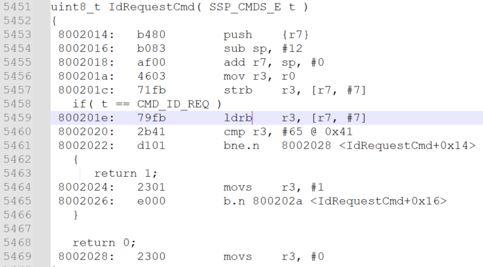

  I checked the generated assembly and it appears that the correct 8-bit code (ldrb) is being generated:

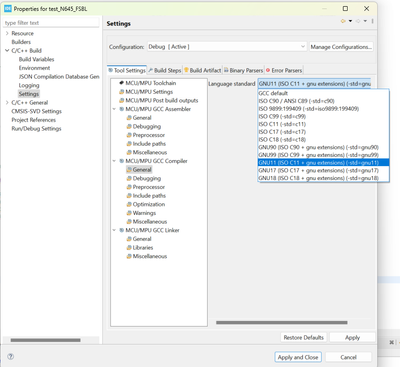

As shown in the screenshot below ,  STM32CubeIDE 1.19.10 supports the following C language standards:
  • ISO C90 / ANSI C89
  • ISO 9899:199409
  • ISO C99
  • ISO C11
  • ISO C17
  • ISO C18
  • GNU extensions for each of the above (e.g., GNU99, GNU11, GNU17, GNU18)
C23 is not listed: The latest standard available is C18 (ISO C18 or GNU18).
The enum underlying type syntax (enum E : unsigned char { ... }) will not be supported by the current toolchain and will result in a syntax error.

Note that the current toolchain does support the syntax, it appears it's just STM32CubeIDE's syntax highlighter that does not.
Is there any plan to update the syntax highlighter or a way to adjust how the syntax highlighter works?

Correct.  The gcc compiler/linker did the right thing as the assembly showed (which is why I included that image).
The problem lies within either Eclipse's or STM32CubeIDE's syntax highlighter.
My question was if there was a switch somewhere within STM32CubeIDE to tell the syntax highlighter what standard to follow.

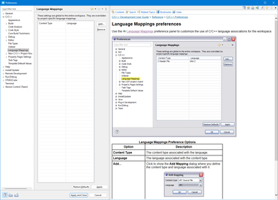

Does this help: https://stackoverflow.com/a/50128081 ?
It's not entirely clear (to me) what this actually does - is it telling Eclipse to use the GCC preprocessor/parser instead of its own built-in one?
The Eclipse online help seems no more informative:

I think that the language settings in Eclipse can be edited if you really want to modify the tool to mask this issue.
