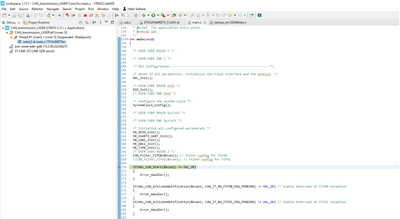

Hello everyone,
I have recently faced a problem concerning the debugger when trying to flash F446RE board.
When i launch the debug mode, the progress bar stops at 97% and doesn't return any error message as output.
The problem did not exist before the holidays but right now it exists although i did not changed the code nor debug config.
Here is the message displayed on the console when trying to debug:

Hello SofLit and thank you for helping me again.
Actually, when i look at the memory window, all the addresses are filled with '?' characters. The flash memory should not be flashed then...

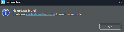

Could you please use the latest version of CubeIDE: V1.16.0?
I am using CubeIDE
Here is the message when looking for an update:
Could you please uninstall CubeIDE and install the latest version?
