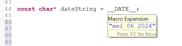

__DATE__ macro expansion incorrect in editor
Gcc and Visual Studio correctly compile today's date __DATE__ to "May  6 2024". However STM32CubeIDE editor expands the macro incorrectly if I hover the cursor over it.
  • Month name is in Dutch
  • Month name is in lower case
  • Day of month is left-padded with 0 instead of a space

It is indeed a relatively minor issue, but it can be frustrating if the editor lies to you about the value of a macro while debugging said macro. It also makes me distrust other values.

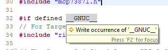

In the case of __GNUC__, the IDE doesn't even try to expand it:
@SofLit  - Maybe that would be a better solution?
PS:
But why does it say, "Write occurrence"? See separate thread.

As also noted earlier, I think a better solution would be to treat it as for things like __GNUC__ - where it doesn't even try to expand it.

I tried to research the cause of the bug.
First I checked the Eclipse CDT repo: https://github.com/eclipse-cdt/cdt
I searched for the macro: https://github.com/search?q=repo%3Aeclipse-cdt%2Fcdt%20__DATE__&type=code
I found this function:
private static final DynamicMacro __DATE__ = new DateMacro("__DATE__".toCharArray()); //$NON-NLS-1$
And it uses DateMacro which has the following method:
private char[] createDate() {
		char[] charArray;
		StringBuilder buffer = new StringBuilder("\""); //$NON-NLS-1$
		Calendar cal = Calendar.getInstance();
		DateFormatSymbols dfs = new DateFormatSymbols(Locale.ENGLISH);
		buffer.append(dfs.getShortMonths()[cal.get(Calendar.MONTH)]);
		buffer.append(" "); //$NON-NLS-1$
		int dom = cal.get(Calendar.DAY_OF_MONTH);
		if (dom < 10) {
		buffer.append(dom);
		buffer.append(cal.get(Calendar.YEAR));
		buffer.append("\""); //$NON-NLS-1$
		charArray = buffer.toString().toCharArray();
		return charArray;
These lines matter:
if (dom < 10) {
buffer.append(dom);
As you can see a space is inserted and not a 0. So this is not a bug in CDT. At least not in the current version.
In an earlier version there was the language of the month bug that was fixed Aug 30, 2024 by ST:
https://github.com/eclipse-cdt/cdt/commit/9b09dce3a05daef6aa2763de629e6f72650794ef
There was an issue about the day of month too: https://github.com/eclipse-cdt/cdt/pull/896
I think the issue is that the fix is after the latest CDT release: CDT 11.6.1 Jul 3, 2024. And STM32CubeIDE V1.17.0 uses 11.4.0.2023. So either we wait for CDT to create a new release and ST updating their version of CDT to that version or ST makes a hot fix.
