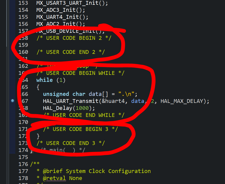

Hello i'm new at using stm32ide
every time i make a change in the pin editor the generated code remove my application from the main.c file
i try to find solutions online i couldn't find any how can i edit my MCAL layer without losing my code ?
In the generated files, there are regions marked with USER CODE BEGIN and USER CODE END. You may only modify code within those sections.
Here are three of many such sections:

Keep your code within USER CODE blocks and don't make modifications outside of those.
thanks for your reply
it works with me
