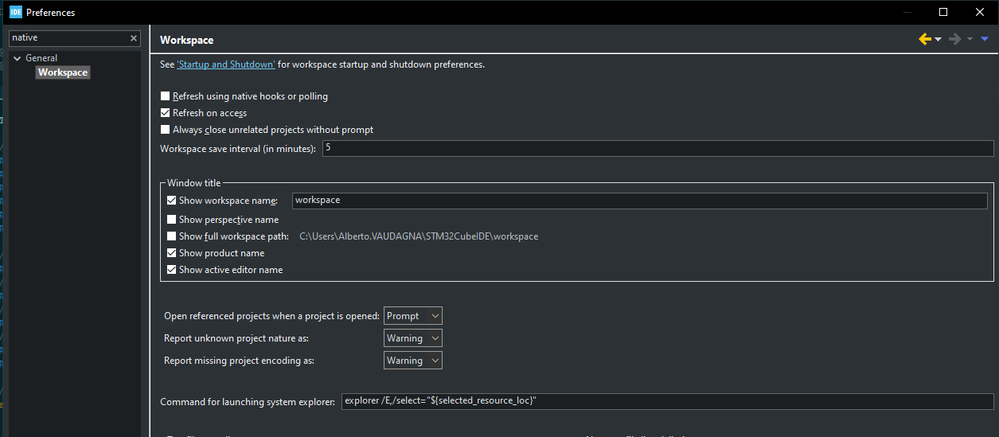

vaualbusBest answer
Mar 2, 2026 3:03 PM UTC
Disable "Refresh using native hooks or pooling" in workspace settings
When that was ticked also in previous version the issue happened. This was automatically re enable in new update, guess they didn't know it cause problem and enable it to on by default.

vaualbusBest answer

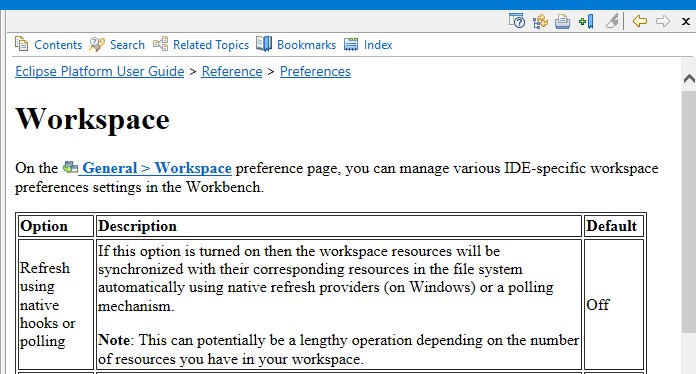

The help for that option says:
I wonder if they turned that ON to overcome the issues reported with v2.0.0 not seeing updates made externally by CubeMX ... ?
