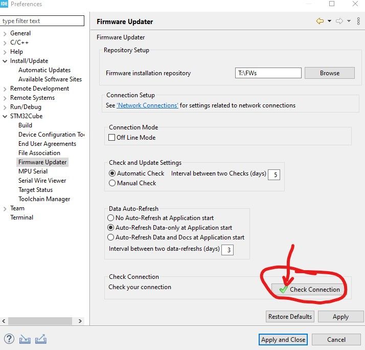

Are you able to get following green check ?
slawek
Yes
