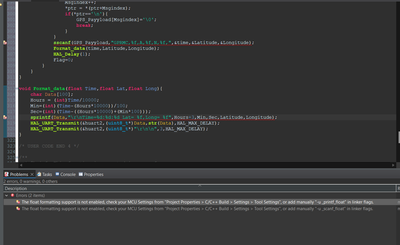

couldn't use sprintf
Priyaa
how to solve this problem

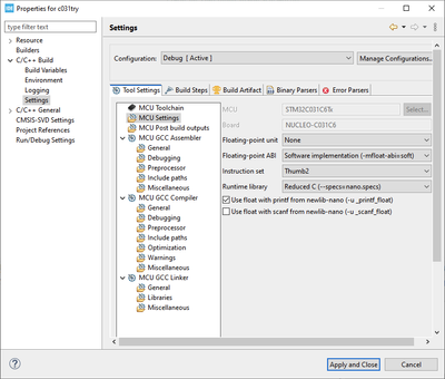

Simply do what's written in the message - MCU settings:

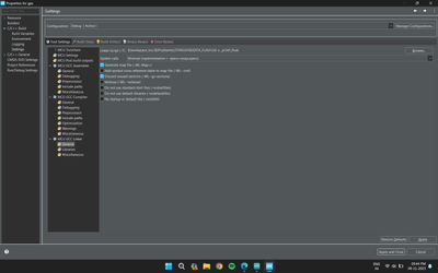

This topic's been covered several times, you might have to fight if it keeps pulling the wrong libraries, not a fan of CubeIDE
Watch you have enough spaces separating parameters, and that compiler and linker accept them
https://community.st.com/t5/stm32cubeide-mcus/how-to-use-float-in-printf/m-p/323872
