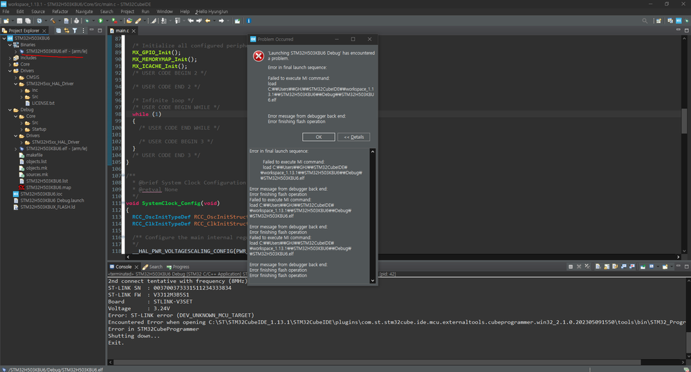

STM32CubeIDE 1.13.1 -> STM32H503KBU6 Download error
HJ.Goo
2 REPLIES 2
Mahmoud Ben Romdhane
Hello @HJ.Goo,
It is the same topic that has been discussed here.
Thanks.
Mahmoud.
HJ.Goo
Think!
After changing the initialization pin from NJTRST to RESET# pin, normal operation was confirmed.
