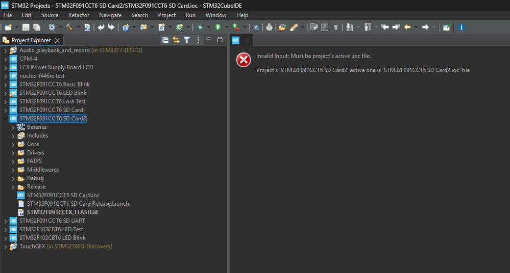

When I copy a project within the IDE, it doesn't update the file references and the IOC file doesn't open. Can we have this fixed asap please?

In particular, you haven't said what version of CubeIDE you're using.
But, yes - I have seen this issue going back to v1.13.0
As a workaround, you can just rename the .ioc file to have the same name as the project.

I am on version 1.19.0.
It seems to work for now after renaming the IOC,  recompiling and setting up a new run configuration.
