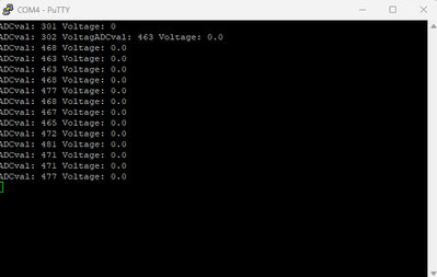

Currently in the process of coding an MQ5 gas sensor, right now I was able to get the ADC value to appear on the serial terminal using PuTTy, but for whatever reason the voltage value always produces zero. I tried also changing the formula to have it produce millivolts instead of volts, but that doesn't seem to work either. Below is my code and the serial PuTTy output:

  Voltage = ADCval / 4095 * 3.3;   //Obtains voltage value by taking ADC value from HAL, dividing it by the 16 bit resolution,
        //And multiplying it by the reference voltage of the STM32 (3.3V)
  sprintf(msg, "ADCval: %hu", ADCval);        //Stores the voltage value (unsigned short 16 bit integer) from the ADC into the msg buffer
  HAL_UART_Transmit(&huart2, (uint8_t*)msg, strlen(msg), HAL_MAX_DELAY); //After the data is stored from sprintf, this line transmits that data onto the serial PuTTy
  sprintf(msg, " Voltage: %0.f \r\n", Voltage);

    Best answer by AScha.3
    1. Try to print, what you get from adc - no "calculation" at first, looks like you get real adc value.
    2. If calculate in INT , never divide at first - maybe, compiler doing as you order him: then (adc 12bit value)/(12bit) -> close to zero, if still INT = 0 (no fractional share, then (float * 3,3 ) -> still zero.
    better : (adc 12bit value)* (float 3,3 ) -> float xxxx,xx /(4095) -> still float x,xxx . (It is about: how numbers converted + calculated , depending on : what you "tell" the compiler to do )
    2 replies
    AScha.3
    AScha.3Best answer
    December 24, 2023
    DRicc.2
    DRicc.2Author
    December 24, 2023
    I figured out the issue,
    Firstly the formula I wrote is wrong, to properly convert the ADC value, I must multiply the supply voltage from the ADC reading (in this case 5 volts), then divide by the bit resolutions (4095 since it's a 16 bit channel). The float that I am trying to print in the terminal did not have enough decimal places, I should have put 0.5f instead of 0.1f, also the ADC value must be multiplied by a float, NOT an integer, and the fixed code is as follows:
    Voltage = (ADCval *5.0) /(4095);
    sprintf(msg, " Voltage: %0.5f \r\n", Voltage);
