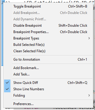

Anyway, if I try to write DWT in the expression window, the symbol is unknown and it seems that is not possible to add watchpoints (the menù entry is disabled).
@davidlora
If I right-click on a breakpoint, the "Profile Instruction Counter" option isn't present in the context menù.
Could it be that "Profile Instruction Counter" is an external plug-in or that my IDE version (v.1.11.2) is too old?
Or that "Profile Instruction Counter" is a watchpoint context menu option, instead of a breakpoint one?
