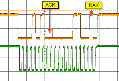

I attached the code. It is a very basic CubeIDE project which uses I2C3. It has a very simple loop in main.c which tries to do a mem read on 0x14 adr 0x12 every 500ms
The i2c blocks after two attempts.
First read attempt: Deviceaddress is ACKed, Sub-address is "NAKed"
I try to talk to a LTC1760 which rejects a subaddress, if it is not available.
This transaciton ends "normal".

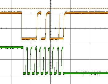

Now, If I try to repeat that, the result is:
Not the bus is stuck. Clock is stuck low (STM32 holds it low) the I2c Hardware shows the "busy flag".
See attached project (STM32G474RET6)
The Bus can be reset by clearing the PE bit in CR1, waiting a few cycles and setting it again
