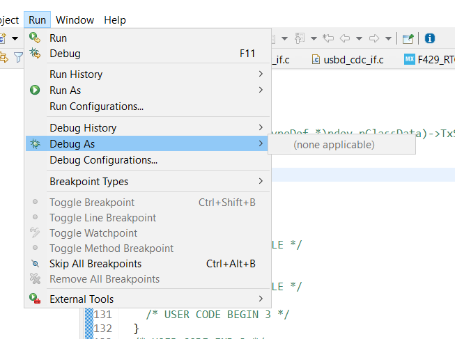

I needed to prepare laptop for some coding purposes and I installed Cube IDE 1.6.1, ST-Link Utility and drivers (v 4.2) and Cube programmer (v 2.6). All is OK, except the fact that I can't create any Run/Debug configuration (when I try to do it program gets stuck. Same happens when I try to open previously created debug configuration (another PC, same SW versions).
I'm running Win10.
Would be very grateful for some help, as I need to debug some stuff in the field.

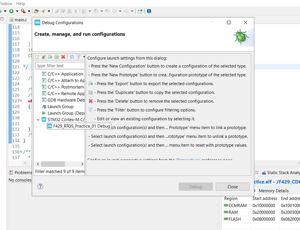

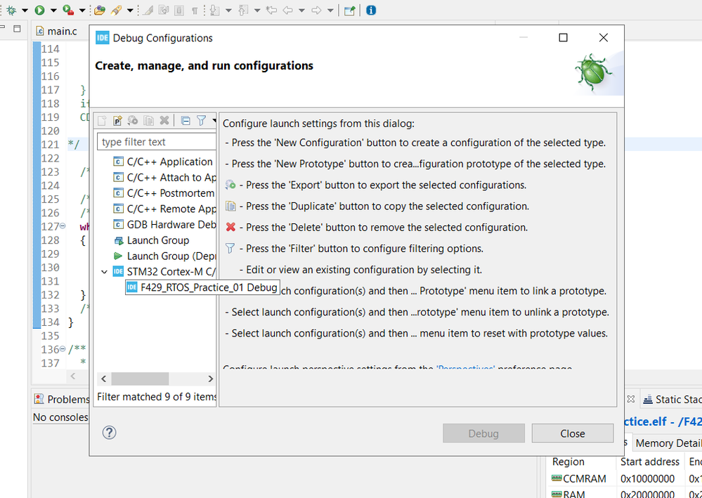

The point is that I cannot create nor edit a debug configuration. If I click Run > Debug As I don't have any configuration available (even if I import the project from another system that runs perfectly fine with same software versions - I don't have its debug configuration - the file is in the system, yet is not interpreted by IDE; see "Screenshot_1.png"). If I try to create a new configuration - IDE gets stuck and does not respond anymore (see "Screenshot_2.png" and "Scfreenshot_3.png" - in fact they are almost identical - no pop-up window appeared, and IDE got stuck). I've been thinking of some problem with GDB server or maybe toolchain, but until now - I could not find a solution.

Probably SOLVED.
I will try not to use mean language, but the #$%^#^#^ firewall was blocking GDB server...
I will test to fully confirm the that it was really the problem.
