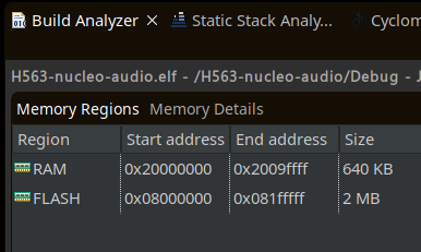

When I open Build Analyzer it's empty. When I see other people open it, they get information about RAM usage.
What have I missed to not get this information?

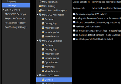

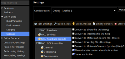

    build analyzer = flash, ram used , you dont see in debug , just after compile you can see it.
    -> for project, you select (= focus is on it)
    see: -> selected project
    then see:
    in settings you must not disable this in project settings:

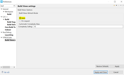

    Hello @DLid.1 ,
    If you are using CubeIDE 1.15.0, you need to enable 'Auto' for the build views refresh mode in [Window]>[Preferences]>[STM32Cube]>[Build Views Settings], then restart CubeIDE.
    Thanks,

    Hello @MiguelDK
    After following the steps mentioned by Rim, you have to click on the 'Refresh' button:
    KR,
    Souhaib

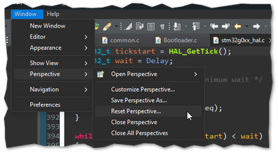

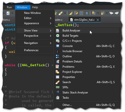

    November 29, 2024
    Hi
    I have now solved the problem.
    I had to press: [Window]>[Perspective]>[Reset Perspective...]
    This brought back the Build Analyzer
    Miguel
