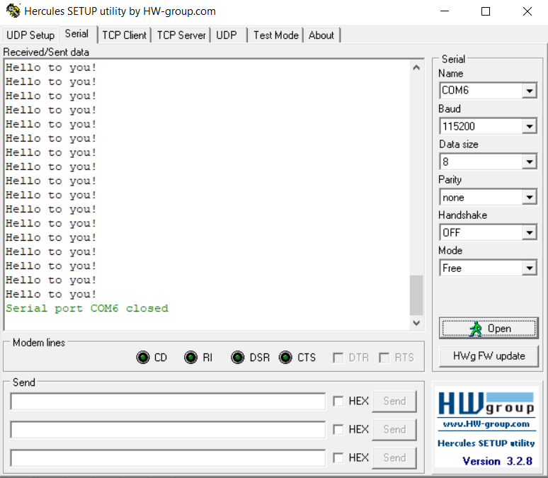

‎2021-07-06 9:08 AM
I have STM32F373VBT.
But also I have solder two USB cables together because my local store did not have USB female to USB female.
Sometimes I get connection. So perhaps...it's a bad USB cabel because I get connections some times.
Like now...I have connection. (I moved on the cable ). Now it seems to work every time. Just because I moved on the cable. So I think you have a bad USB cable. Notice that USB cable is very sensitive because it's parallell signals.
‎2021-07-06 9:11 AM
My cable is s-hit like crap. I cut it to half and solder it with another cable so I could have female to female USB.
I'm building my own boards from scratch.
But it seems to work now, when I moved the cable.
I plug it out, plug it in. Yes...connection.
‎2021-07-06 9:13 AM
If you want. I can give you my project if you have a STM32F373VBT uC?
‎2021-07-06 9:17 AM
Now when I thinking of it!
Yes! The board need first connection because the uC is tooo fast.
If I unplug the USB cable completly, then USB connection wont establish.
But if I just drag the USB cable out 2-3 mm, but still have current source connection to my uC, then press the USB plug in again.
Then I get USB connection :)
Thank you!
‎2021-07-06 9:30 AM
You're welcome. I'm using a new released uC. The software pack is not perfect yet. Wish me luck!
‎2021-07-06 3:13 PM
By the way!
It works much better if I place MX_USB_DEVICE_Init(); closer to MX_GPIO_Init. Then I will have connection directly when I plug it into the PC.
