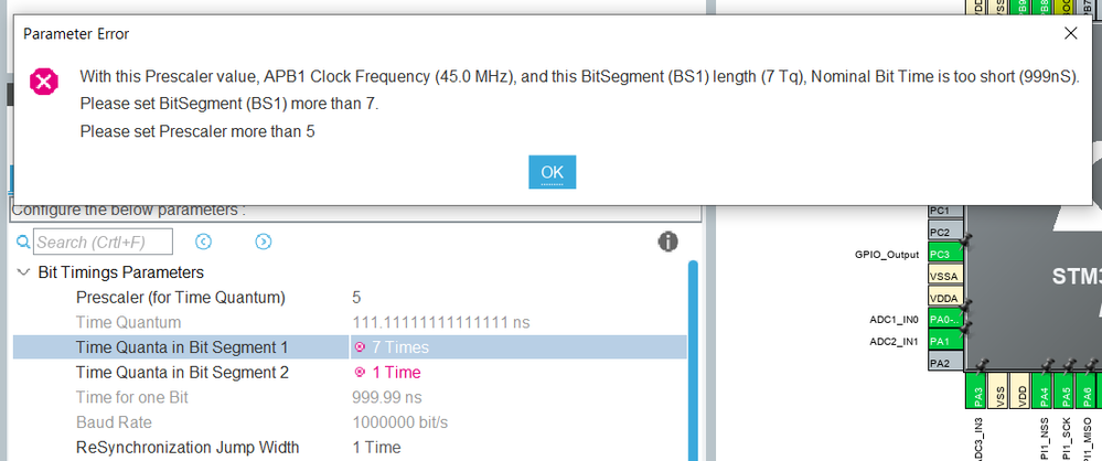

2021-01-07 7:11 PM
I have a same problem.
I'm using STM32F446RE and set bxCAN to 1Mbps with settings:
- ABP1 Colck : 45MHz
- prescaler : 5
- Time Quanta in Bit Segment 1: 7 Times
- Time Quanta in Bit Segment 2: 1 Time
- ReSynchronization Jump Width: 1 Time
With this setting, I have been using it for over a year without any problems.

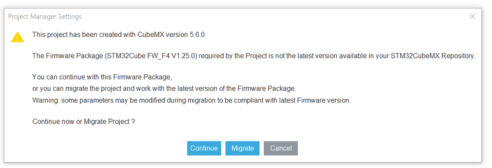

But after migrate my cubemx project to 6.1.0(current version) parameter error occur.
2021-02-01 3:20 AM
same problem here. It is wrong rouding.
111.1111111111111111*(7+1+1) = 999.9999999999999999 which should be rounded to 1000 ns.
In my case APB1 clock frequency 42 MHz. Time qauntum
47.61904761904762*(16+4+1) = 1000.00000000000002
