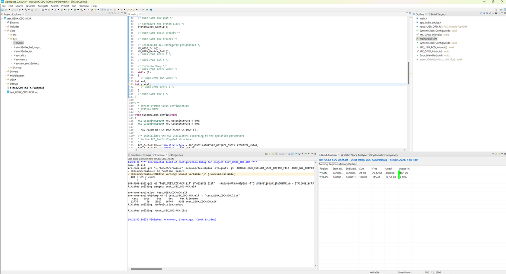

   i am encountering this issue very frequently, the build analyzer unable to update after modified code and build, run.
i have click the 2-round arrow on the top right menu, and click "on request "on view build setting. Yet still unable to update build analyzer. Anyone can advise?

Hello @HMSEdinburge
I have performed a test using STM32CubeIDE 2.1.0 and it's working just fine.
Let's try to
1- File → Switch Workspace → Other…
2- Choose a new empty folder.
In the new workspace:
3- File → Import → Existing Projects into Workspace.
4- Import your current project.
5- Clean + build the project.
6- Open Build Analyzer in this new workspace.
THX
Ghofrane

The Build Analyzer is working for me, but (specialy if you have more then 1 build configuration) you have to select first the *.elf file you want to analyze , an the press the "refresh" button.
P.s. the Build Analyzer in VSCode has still some limit's and is not on the same level as the STM32CubeIDE Analyser.
