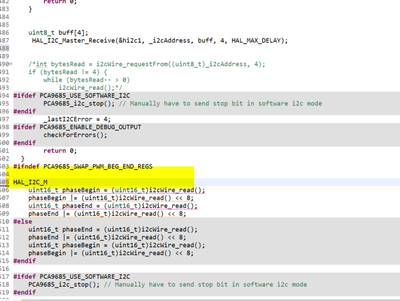

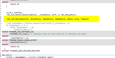

I am trying to add HAL_I2C_Mem_Read into my application. However, when I write the API in the region below, it is not auto filled, I can not use the API. On the other hand, when I add the API inside the above function it works.
How can I fix this ?
I have already added #include "stm32f4xx_hal_i2c.h" as header file.

What is this?

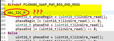

I have deliberately pointed out that to show there is no auto fill when I start to type HAL_I2C_M in that region, on the contrary when I start to type in the function body as HAL_I2C_M and press space, then I see the API in the suggestion list that is HAL_I2C_Mem_Read()
In brief, my question is that, why HAL_I2C_Mem_Read is not useable outside of the function body ?
